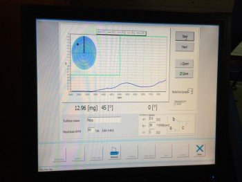

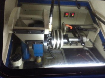

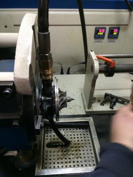

Kenbobo Posted December 12, 2014 Author Report Posted December 12, 2014 Goodies de la cel care mi-a reconditionat turbo: PS: Stie cineva sa interpreteze graficul? ca eu habar nu am
