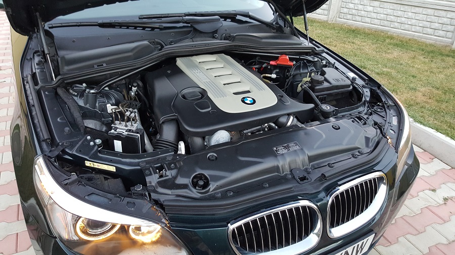

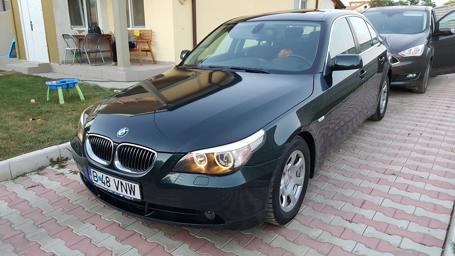

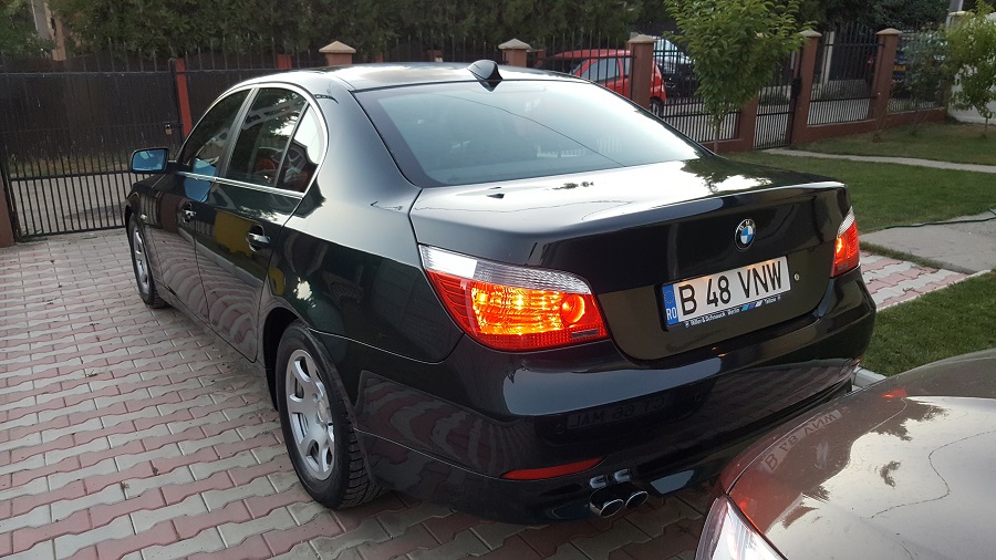

MirceaSI Posted August 4, 2016 Author Report Posted August 4, 2016 (edited) 2497 cmc. Poze: Ce am facut pana acum: - am pus folie omologata; - am schimbat tot ce inseamna bec cu led; - am vopsit bara fata; - detailing interior / exterior / motor; - azi rezolv cu senzorul SZL, m-a ajutat un prieten cu un senzor nou; Ce urmeaza sa fac: - discuri si placute fata; - probabil bielete antiruliu- trebuie investigat; - revizie cutie; - jante pe 17/18; - led marker angel eyes;; - mai astept si idei de la voi; Vehicle informationVIN long WBANC51000CN43529Type code NC51Type 525D (EUR)Dev. series E60 ()Line 5Body type LIMSteering LLDoor count 4Engine M57/TUCubical capacity 2.50Power 130Transmision HECKGearbox AUTColour TIEFGRUEN METALLIC (A43)Upholstery STOFF FLUID/ANTHRAZIT (ALAT)Order optionsNo. Description1CA SELECTION COP RELEVANT VEHICLES205 AUTOMATIC TRANSMISSION320 MODEL DESIGNATION, DELETION403 GLAS ROOF, ELECTRIC423 FLOOR MATS, VELOUR428 WARNING TRIANGLE431 INTERIOR RR VW MIRROR W AUT ANTI-D438 WOOD TRIM488 LUMBAR SUPPORT DRIVER/FRONT PASSENGER494 SEAT HEATING F DRIVER/FRONT PASSENGER502 HEADLIGHT WASHER SYSTEM508 PARK DISTANCE CONTROL (PDC)522 XENON LIGHT534 AUTOMATIC AIR CONDITIONING536 AUXILIARY HEATING540 CRUISE CONTROL606 NAVIGATION SYSTEM BUSINESS644 PREP. FOR. MOB. PH. BLUET. INTERF.698 AREA-CODE 27RP ADVANTAGE PACKAGE8SA COUNTRY SPEC. RELEASE OF NAVIGATION8SP COP CONTROL801 GERMANY VERSION863 EUROPE/DEALER DIRECTORY879 GERMAN / ON-BOARD DOCUMENTATION9AA EXTERNAL SKIN PROTECTION934 WINTER TYRES ON LT/ALY WHEELS936 REQUEST BMW MOBILE PHONE ON DELIVERY969 REQUEST NAVIGATION DVD ON SHIPPINGSeries optionsNo. Description2RA LT/ALY WHEELS TRAPEZE STYLING 134548 SPEEDOMETER WITH KILOMETER READING851 LANGUAGE VERSION GERMAN Edited August 4, 2016 by MirceaSI 1 Quote

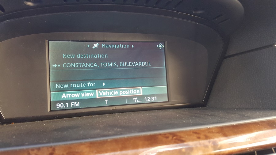

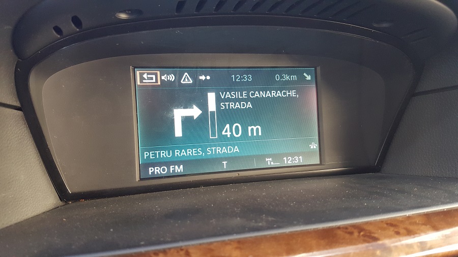

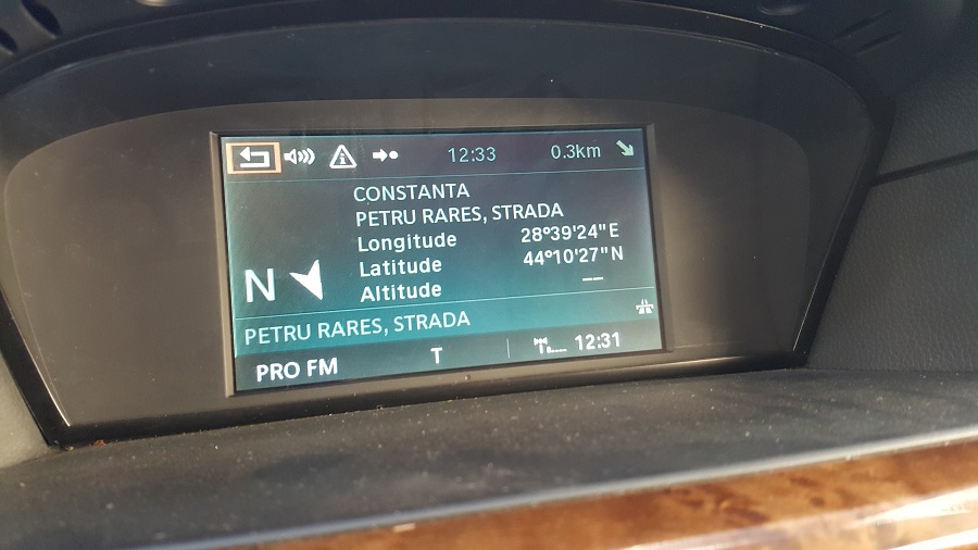

MirceaSI Posted August 4, 2016 Author Report Posted August 4, 2016 (edited) E navigatie d-aia mica, arata doar o sageata sau nu stiu eu sa umbu cu ea. Poate ma lumineaza si pe mine cineva cu ea. Since sa fiu, nici nu mi-am batut capul... PS Am mai schimbat si chederul de la luneta, era praf, copt, nu mai era... Edited August 4, 2016 by MirceaSI Quote

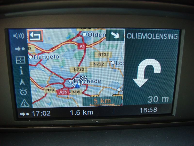

Pole Posted August 4, 2016 Report Posted August 4, 2016 nici nu-ti bate, nu stiu cum e la mica ca am navi mare, insa tre sa iti arate si harta, nu doar sageti ceva de genul, asta din poza e business cum ai tu. tre sa te duci cu rotita de la idrive in partea stanga dupa ce intri in navigatie, apesi pe buton de sus in jos si iti apar niste optiuni, alegi ceva de genul "prespective" sau "vehicle position" si apari pe harta. asa e la mine. practici separi ecranul in doua, in stanga in arata harta si in dreapta ce vrei tu, trip computer, info, etc. Quote

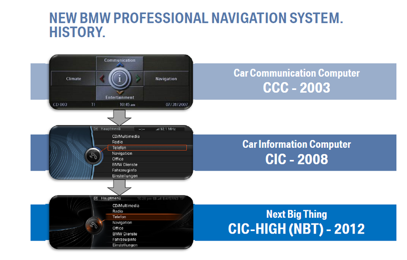

jeleu Posted August 4, 2016 Report Posted August 4, 2016 Se poate face retrofit la CIC sau chiar NBT. Quote
MirceaSI Posted August 4, 2016 Author Report Posted August 4, 2016 Deci PLM, sa fie oare de la cd-ul cu harti? Sau chiar nu stie asta sa arate harta? Quote
Pole Posted August 4, 2016 Report Posted August 4, 2016 se pare ca ai o versiune de soft mai veche, care nu arata harta, poti face update de soft la reprezentanta, e in jur de 300 de lei parca, ar fi bine, ca faci update si la toate modulele masinii, nu numai pentru navi, ceea ce nu poate fi decat un lucru bun si recomandat. ps: nu face update decat la reprezentanta, nu la nush ce baieti, ca daca se blocheaza vreun modul, ai belit-o http://5series.net/forums/e60-discussion-2/business-navigation-upgrade-2d-maps-62341/ Quote
Scufi Posted August 4, 2016 Report Posted August 4, 2016 Se poate face retrofit la CIC sau chiar NBT. cic? nbt? io-s curios Quote
Pole Posted August 4, 2016 Report Posted August 4, 2016 pai ca la F-uri http://www.e90post.com/forums/showthread.php?t=770381 Quote
