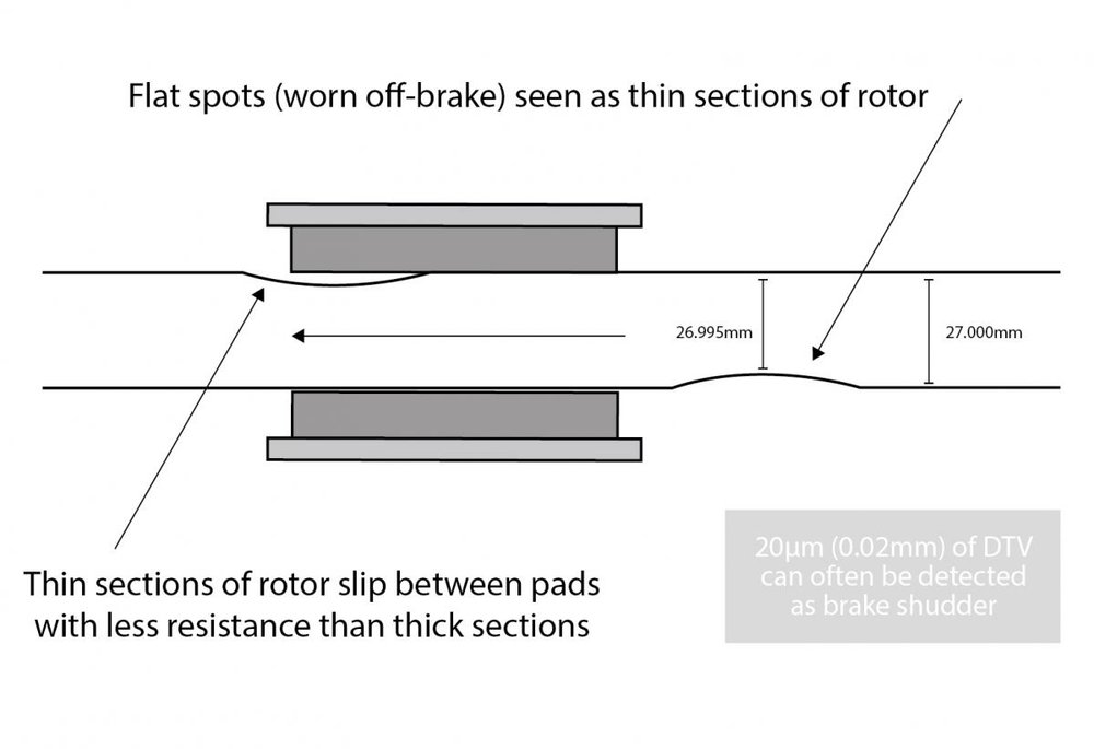

Scufi Posted August 14, 2016 Report Posted August 14, 2016 aia nu e ovalizare lol, ci uzura inegala. chiar si in linkul ala, iti zice: Disc Thickness Variation Quote
Scufi Posted August 14, 2016 Report Posted August 14, 2016 Da, pe un material publicitar, nu pe o fisa tehnica. hai ba ciupa ca am pretentii. Quote
Bogdan Posted August 14, 2016 Report Posted August 14, 2016 (edited) Nu-ti face iluzii ca sa nu ai deziluzii. Deci producatorul poate abera pe propriul site cand vine vorba de chestii tehnice? Brembo = AcasaTV? Edited August 14, 2016 by Bogdan Quote
Scufi Posted August 14, 2016 Report Posted August 14, 2016 Azi sunt plictisit, nu prea am chef sa explic. Fiecare crede ce vrea Quote
