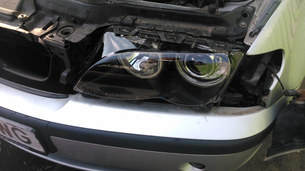

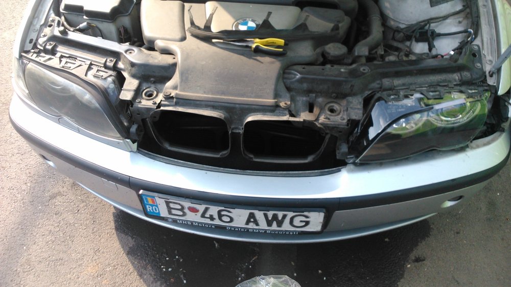

Krebs Posted March 14, 2014 Author Report Posted March 14, 2014 mie nu mi se pare ok aia, parca nu are suficient adeziv..puiiiii , mei ..fiecare cu "pasarelele" lui Quote

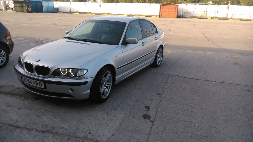

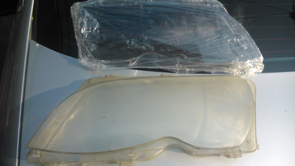

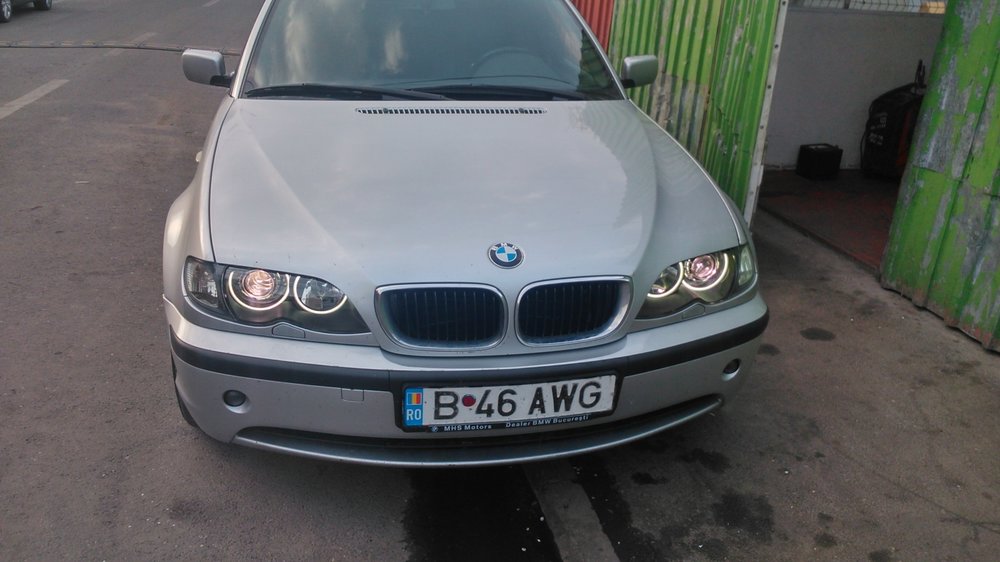

Krebs Posted April 1, 2014 Author Report Posted April 1, 2014 (edited) nu stiu ce se intelege prin poze dar diferenta este uriasa live ! si cred ca imi lumineaza si mai bine xenoanele acum Edited April 1, 2014 by Krebs 1 Quote
Simi ON Posted April 1, 2014 Report Posted April 1, 2014 MiÅŸto. Pacat ca nu pot si eu la fel, la rabla Quote
Krebs Posted April 1, 2014 Author Report Posted April 1, 2014 ba se poate !uite de aici le-am luat si eu si sunt chiar misto facute geamurile. http://tobe-sport.ro/?229,sticla-far-bmw-e39-facelift-1999-2004-doar-175-ron Quote
Cefi Posted April 1, 2014 Report Posted April 1, 2014 Similea, las o in plm nu mai baga bani in coteÈ› Quote
Bogdan Posted April 1, 2014 Report Posted April 1, 2014 Foarte misto cu sticlele noi. Chiar merita asa ceva pentru ca vei vedea mult mai bine noaptea, deci creste siguranta. Quote

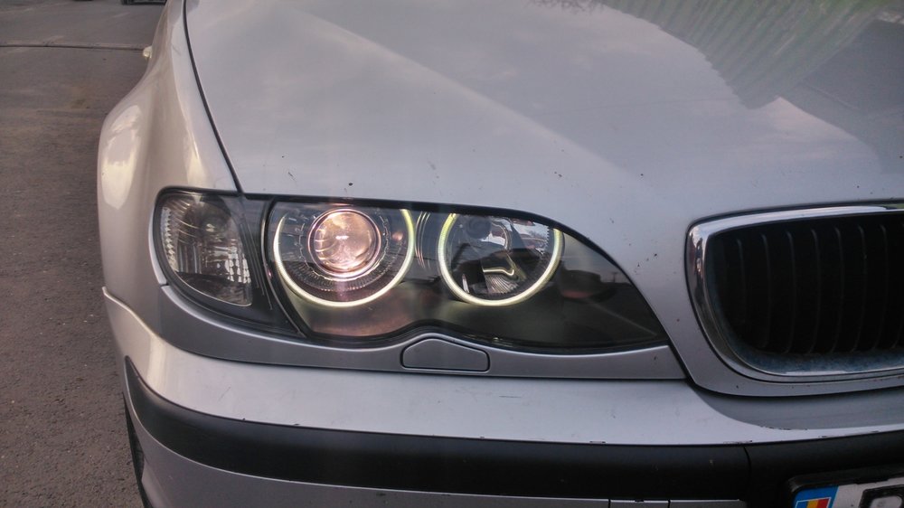

Calin Posted September 19, 2014 Report Posted September 19, 2014 Ai dat jos scotch-ul ala de pe fire? Quote
Krebs Posted September 21, 2014 Author Report Posted September 21, 2014 80% am refacut atunci cu izolir, dar am mai pastrat si pt tine Cosmin, ce ?! Quote
