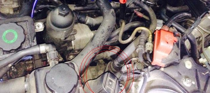

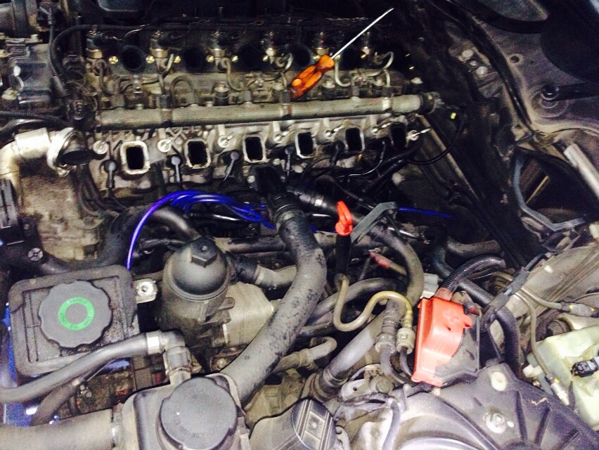

Pole Posted September 30, 2014 Author Report Posted September 30, 2014 cu o mana-n masina lu' pole si cu una pe forum plus atentie distributiva daca nu imi leaga vreun furtun de vacuum la returul de motorina, suntem in schema Quote
Krebs Posted September 30, 2014 Report Posted September 30, 2014 acum monteaza Bogdan furtunele Quote

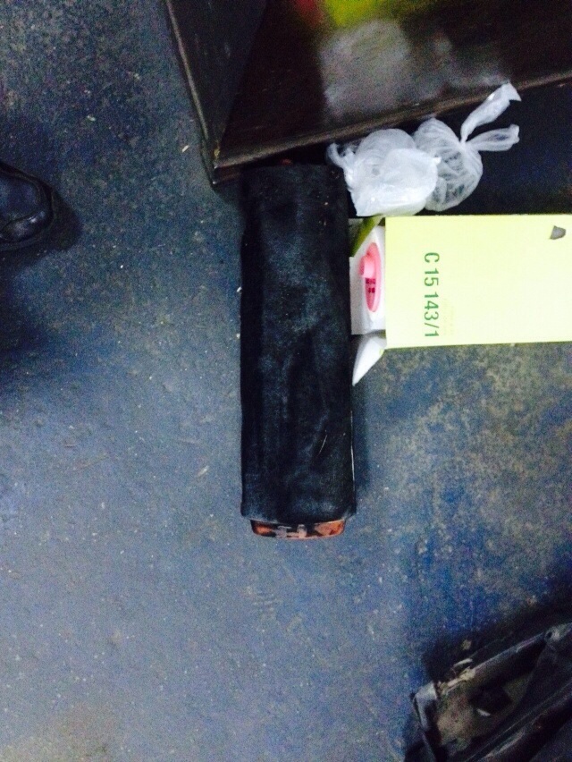

Pole Posted September 30, 2014 Author Report Posted September 30, 2014 furtune(furtunuri?, da furtunuri) siliconate si filtrul meu de aer imbaxit de la galeria sparta... Quote
Krebs Posted September 30, 2014 Report Posted September 30, 2014 misto tare filtru de aer , e dat ulei ca cel de la K&N cool !pai furtunuri normal, pacat ca ai sters poza , era chiar misto Quote
Pole Posted September 30, 2014 Author Report Posted September 30, 2014 pai iti dai seama ca sufla din galerie exact in zona aia, muci treaba. Quote

Pole Posted September 30, 2014 Author Report Posted September 30, 2014 bai vere, deci daca aveti ocazia, sa va schimbati furtunurile de vacuum . Pe langa faptul ca nu mai dau fum deloc (bine, asta poate e si datorita filtrului de aer nou, sau galeria de evacuare schimbata) are alta viata bai nene atelaju', o placere sa rupi fara-n ea. bine, a cam trudit colegu', ca se demonteaza la greu pe acolo ca sa ai acces, plus ca s-a mai schimbat si o garnitura la turbina. @Krebs, asa anula in secunda asta alarma Viper, insa nu stiu cum, in afara de asta, din cauza ei, nu mai pot inchide/deschide din cheia masinii, ci numai din telecomanda alarmei. asadar, daca stii cum scap de ea, zi-mi ca o urasc din suflet. Quote
KIP Posted September 30, 2014 Report Posted September 30, 2014 Cat te a costat toata distractia cu furtunurile si garniturile ? Quote
Pole Posted September 30, 2014 Author Report Posted September 30, 2014 Cat te a costat toata distractia cu furtunurile si garniturile ? Manson turbo admisie - 110 lei O-ring intercooer - 50 lei Furtunuri vacuum - 150 lei Filtru de aer Mann - 140 lei Galerie de evacuare - 700 de lei (din fonta) Garnituri galerie de Evacuare, 6 bucati + 1 la turbo - 150 de lei total piese: 1300 lei Quote
Krebs Posted September 30, 2014 Report Posted September 30, 2014 (edited) nu furtunurile ti-au schimbat masina ci faptul ca nu mai pierzi presiunea din admisie..senzorul ala saracu' , de se ocupa cu presiunea din admisie era zapacit de tot.. nu stiu ce si cum cu alarma, poate stie ciupa' , daca nu la astia cu alarme doar ca umbla ca nepalatii si trag de toate cele fara grija...distrugatori in plm preturile nu-s kilipir unele-s chiar peste piata ,deci kip nu se baga ! Edited September 30, 2014 by Krebs 1 Quote

Calin Posted September 30, 2014 Report Posted September 30, 2014 Ca pixu arata furtunele alea albastre acolo la motor. Cam ca si presurile alea din aluminiu ce le pun altii in interior. 1 Quote
Pole Posted September 30, 2014 Author Report Posted September 30, 2014 nu se vad bre' cand e totul montat la loc. Quote
