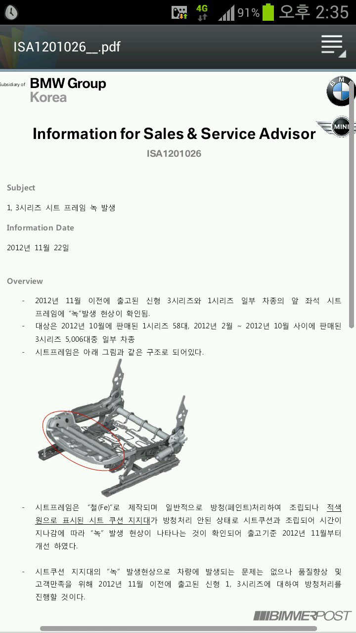

Se pare ca sunt ceva probleme cu rugina la frame-ul scaunelor din fata la F30 / F20, problema care este cunoscuta si de BMW si remediata incepand cu noiembrie 2012.
BMW Group Korea
Information for Sales & Service Advisor ISA1201026
Subject : 1, 3 series seat frame rust
Information Date : 22th Nov 2012
Overview
- We confirmed that there is rust on front seat frame of some of the new 3 series and 1 series released before Nov. 2012.
- These released 58 cars of 1 series in Oct 2012, some of 5006 cars of 3 series from Feb to Oct 2012.
- Seat frame made from steel "Fe", under rust preventative but in this case, we confirmed it's out of rust preventative the part in red circle and we patch it from Nov. 2012
- This is not effective to running the car, but we will work on rust prevention to new 1, 3 series which released Nov 2012, if we find it.
Am cercetat si la mine si este ceva insa superficial, insa o sa merg cu problema sa o semnalez in vederea remedierii pe garantie.
BMW rezolva problema celor existente prin stergerea ruginei insa nu inlocuiesc scaunele.
Informatia a fost preluata de aici
